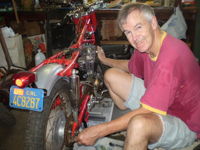

OK, my "in the backyard for 30 years" 1963 CB77 is together and running! Thanks, LM, for the 4th over pistons and gasket set. I now have 18 miles on my rests odometer.
Problem is, the transmission "kicks out" of second gear most of the time. Occasionally it will drive in 2nd, but applying torque seems to make it either jump into neutral, or jump out/in/out/in, which must be wreaking havoc with the dogs.
Normal procedure is rev up in first, then double shift to 3rd. Wish my 2nd and 3rd gears were Xed, to make this a shorter jump.
My gearshift indicator is aligned to 11 o'clock. My clutch works great, after its 30 year+ slumber.
My first bike 1n 1967 was a Super Hawk, and I have had bikes since then, but never worked on a transmission. Has my time come?
I opened up the clutch-side side cover and removed the clutch to check the shifter action, and it shifts fine into all 4 gears + neutral, shifter pawl is registered correctly, etc. Anyone else have this happen to them, and find out what it was? Rounded shift dogs, worn groove for shift fork, bent fork, worn shifter cylinder, or...
