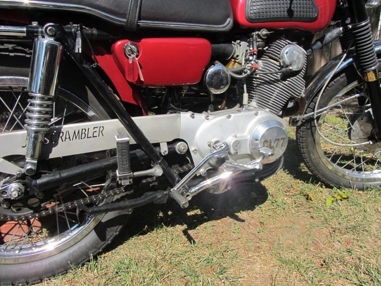

Tried to start the Scrambler the other day and when I kicked down on the kickstarter arm it made a clicking sound on the way down and then stayed in the down position, (see attached photo)
Now I can't pull it up into the normal position.
I'm thinking a buggered pawl on the end of the kickstart shaft where it engages the main gear,
Any of you have an experience with this or Ideas? I haven't attempted to dig into it yet.

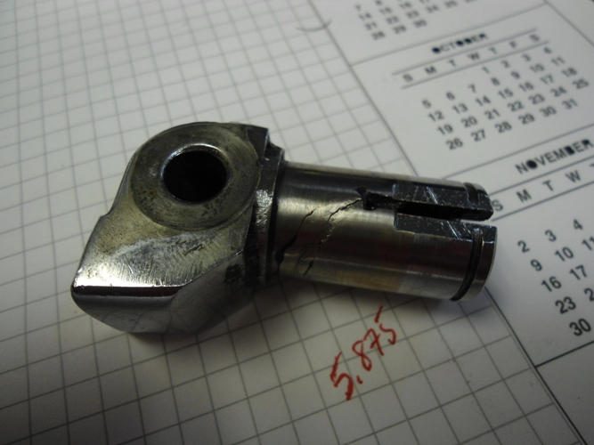

Mike, you nailed it. Pulled the cover and the kick start knuckle was cracked in two places.
Looking for a replacement now. CA's and CL's used the same knuckle 28241-259-000.
Thanks for the heads-up.
Gary

Post by G-Man » Sun Oct 02, 2016 3:51 pm
Pretty expensive if you can find one. They occasionally come up on eBay.
They can be repaired by welding. There is a high stress area where the slot ends. This is where the crack begins.
Drill a hole at the end of the crack to stop it going any further. Grind out the meterial near the crack & weld back up.
