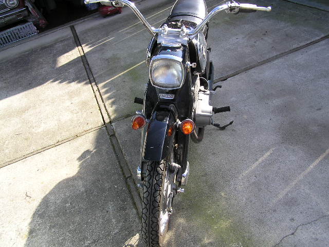

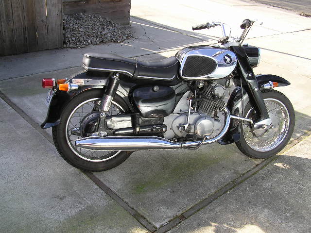

ok i guess i'm a sucker for a sob story. i just bought a 68 dream today for a gentleman that had a stroke and couldn't ride it anymore. so i bought it and yep it has some a little problem ( sticky clutch ) its been sitting for a little over a year. it starts right up and its hard to shift, i read a lot of sticky clutch posts and i'm gonna start it warm it up and drive it around the block several times and see if it'll get going again?
he also put some signal lights on the beast and converted the light switch over to a signal switch everything looks normal and works but the lights?????
is the Bill Silvers restoration books, cd's the way to go?
hers a few pics of big baby
exhaust's in good shape but the seat i think isn't the right one???
wow those blinkers look like bulls horns, krazy

Post by OldStan » Thu Feb 24, 2011 11:26 am
Two good local finds in a row, good work!
I found a reference on that type of seat being introduced some time in 1966. It was in reference to a question on a CB, but I would imagine it would be the same situation on a CA. Someone else may be able to give a more definitive answer.
The usual clutch problem from sitting is stuck, no release at all, not sticky. Once it's broken free, by whatever method, it should work normally. If not, it would be worth pulling the left cover off and taking a look.
California requires headlights at all times. If he'd been riding it, maybe he wired it direct and you have a bad bulb. I'd pull the bulb and check for power there, then work my way back. Just a thought.

Post by Hoosier Tom » Thu Feb 24, 2011 3:23 pm
OldStan wrote: I found a reference on that type of seat being introduced some time in 1966. It was in reference to a question on a CB, but I would imagine it would be the same situation on a CA. Someone else may be able to give a more definitive answer.
Looks like a late CB77 seat. It's got to be more comfortable than the CA77 seat! I'd like to see the underside of that seat to see if is modified to fit the Dream or built that way.

Post by wnbasac » Thu Feb 24, 2011 6:39 pm
1st about the blinker switch and headlight :
> the headlight works ok when you move the key up a slot just no high / low beam switch
the blinkers now occupy that switch i guess thats one way of getting by without the HTF oem signal switch
2nd i'll take the seat off and take some pic's and post them
