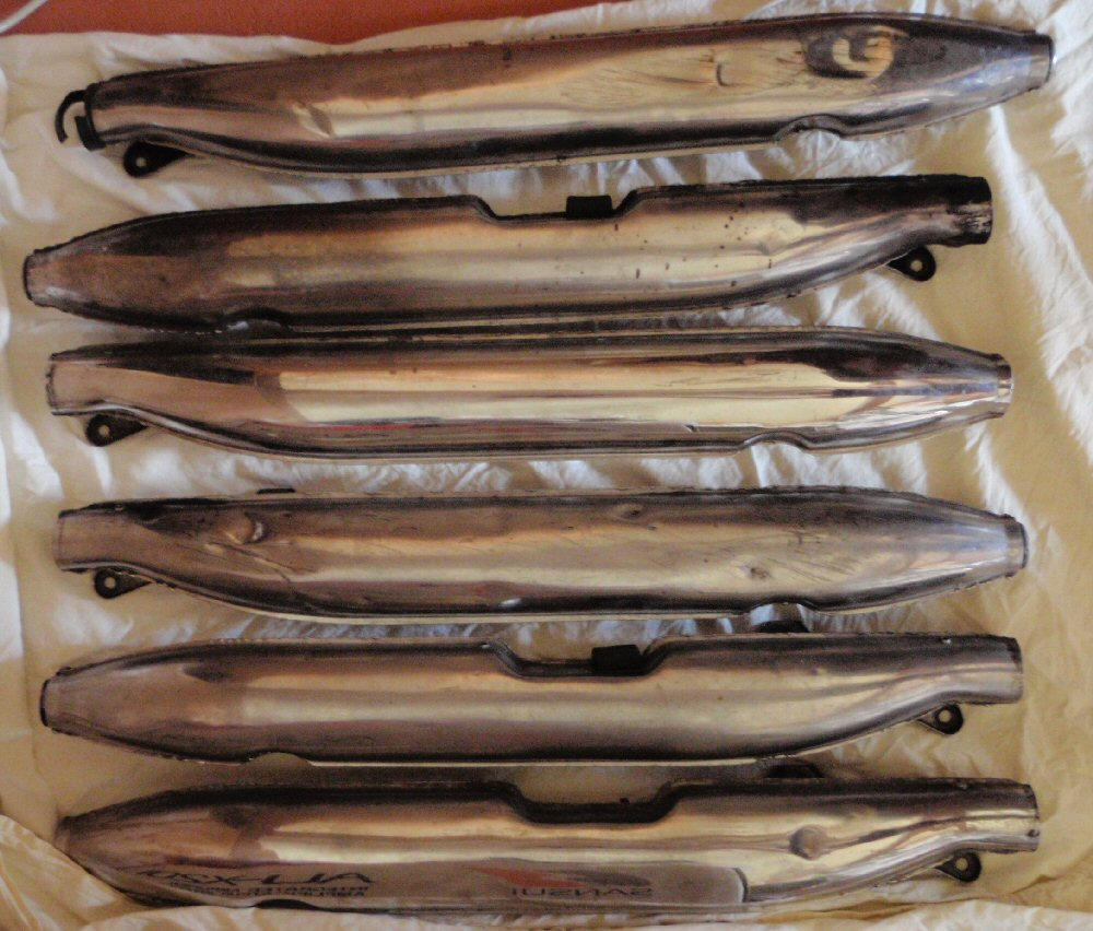

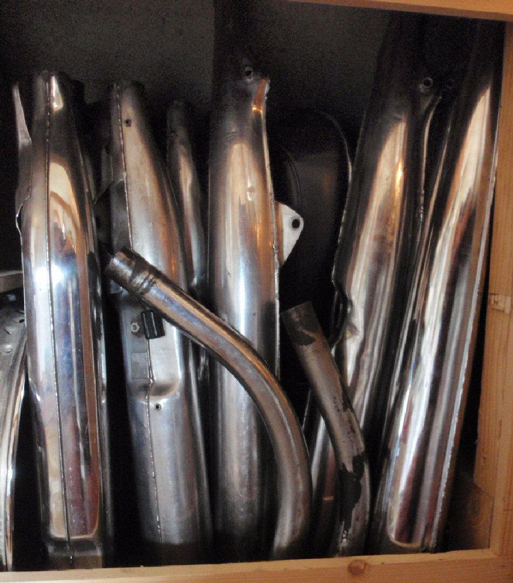

stainless muff
Post by jleewebb » Sat Dec 04, 2010 10:08 am
Not to disrespect or contradict anyone, but I've been told by an expert that my left muffler is stainless; it's got absolutely no rust, in contrast to the right one. A magnet sticks to both mufflers about the same. The welded-on bracket on the left one does show some rust, but not the body of the muffler. Just for what it's worth. --Lee
'62 CB77. "It's a rider."
jensen
Posts: 1143
Location: netherlands, huizen
Post by jensen » Sat Dec 04, 2010 10:40 am
Hi,
That could be the fact, but are you not feeling a slight difference in magnetic force ?
Stainless as phrased for Honda is indeed magnetic, but significant lower than the steel mufflers.
I have many stainless and steel mufflers for CB72's and dreams, and there is a significant difference in force to a magnet.
Are you sure that the "rusted" muffler isn't in fact a stainless one, but with stains on them ?
Look at the pictures very good, you will see stains, not rust.
Jensen
jleewebb
Posts: 472
Location: travis county, tx
magnetic force
Post by jleewebb » Sat Dec 04, 2010 10:55 am
There certainly could be a slight difference in magnetic force, but both feel fairly strong. The right muffler had a good bit of rust on the inside rear near the sprocket. I treated rust there with "neutralizer" (phosphoric acid?) and painted with same extra-high-heat silver I used on the exhaust pipes. Both muffs had typical cracks at the brackets that had to be brazed. All holding together so far. I remember replacing at least one of the mufflers back in the 60's when it rusted through and fell apart/off back back of the bracket.
