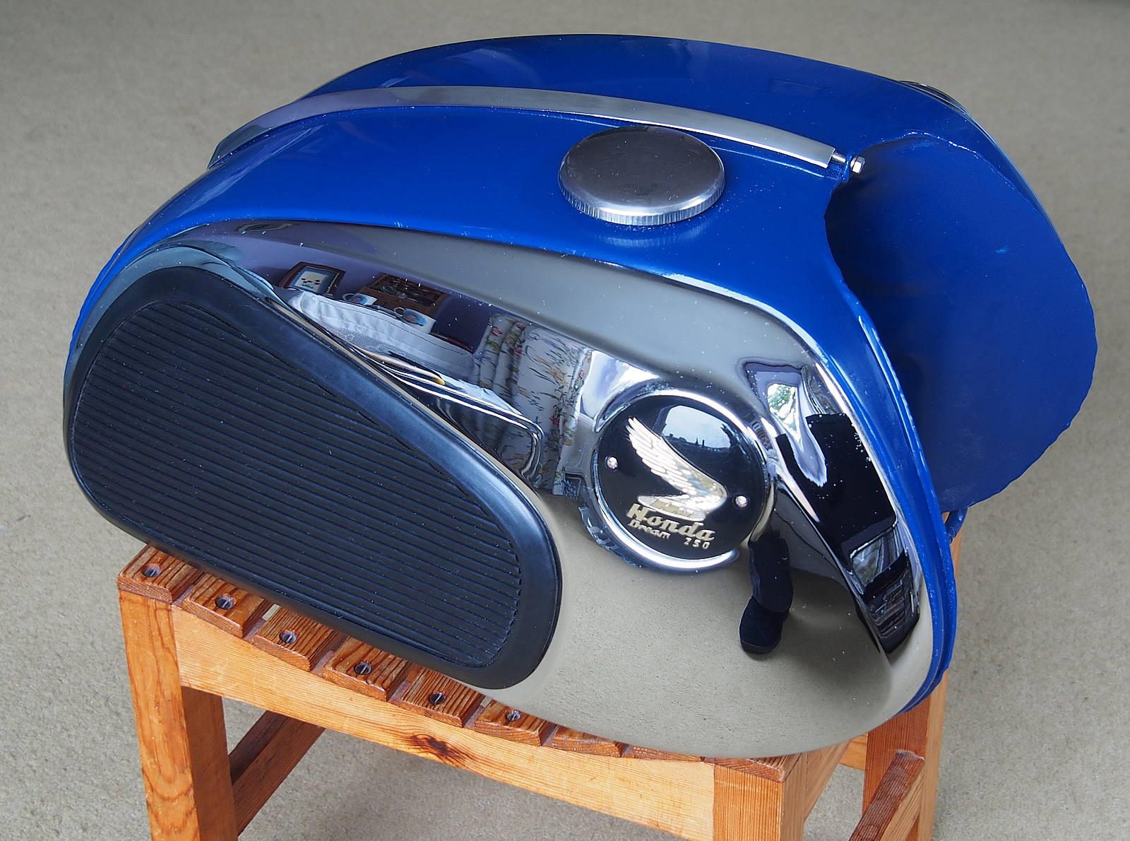

Fantastic find and looks like a pretty easy restoration. I have just finished work on a 1962 C72 tank and notice that you have the original chrome tank strip on there too. That will look really nice.

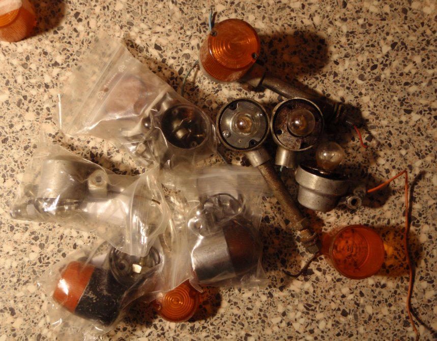

Hi,
Thank you so much for the pictures !
I really must say, I've never seen those winkers, and I have seen a lot.
Therefore, I can't answer the question if these are original or not.
If you are dissembling the bike you could look to the wire colors of the winkers.
Honda used orange and light blue, after market wires are mostly black or green.
I'm very interested in pictures of your wires and harness, also of the winker relay.
and indeed, like G says, in the frame number and harness tag.
Jensen

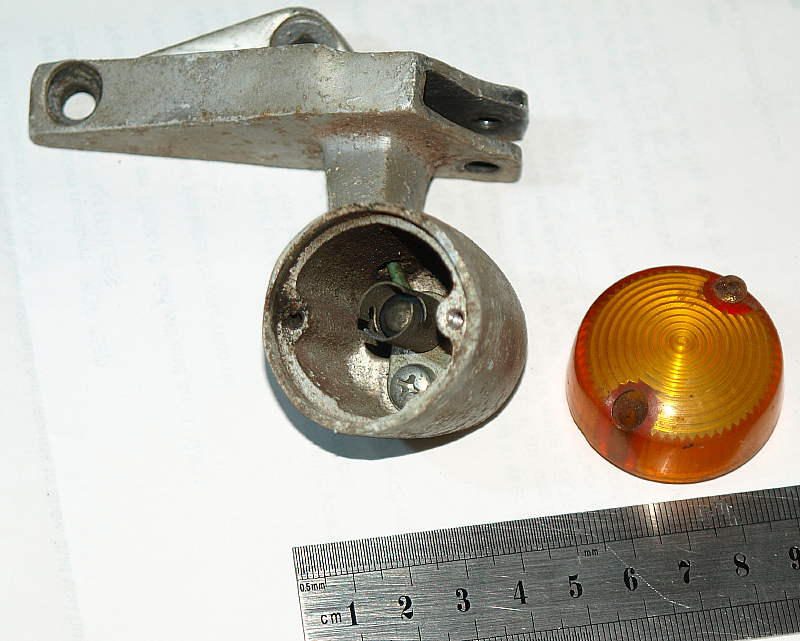

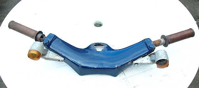

Post by G-Man » Sat Oct 06, 2012 2:27 am
Kellie
Frame number is below the left hand swing arm pivot near rear brake switch.
I think that the winker lenses are the same as item 4 on this page.
http://www.cmsnl.com/honda-c72_model743 ... ml#results
Honda used a lot of different winkers and attachments to cope with different market requirements. Yours will be a nice unusual bike when it's done.
I have a C72 with pressed handlebars which uses a similar lens but with different fitting. I have seen the lenses come up on eBay and think that they have a Honda Cub part number. 33405-001-610
The lens is also the same (I think) as the Japanese model CL72 and CB72 when fitted with winkers.
http://www.ebay.co.uk/itm/HONDA-CB77-CB ... 233wt_1182
