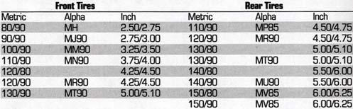

Currently there are not that many companies that still produce this size. A good substitue is a 100/90-16 tire (metric system). This means that the width of the tire is 100mm (3.93 in) and the height of the tire is 90% of the width (or 100 x 0.9) = 90mm (3.54in). I need a little help explaining this one, because it seems like this tire would be too wide, but everyone keeps suggesting it... a graphic below shows conversions from metric in inch tire sizes. It was found at this site

Tire conversion chart<br />http://www.heeters.com/tirechart.shtml

This is good stuff. However, despite the info you've displayed which presumably comes from a reputable retailer, tire designation is based on wheel outside diameter, not tire outside diameter. I'm not sure what motorcycles to which "tirechart.jpg" refers, but it's not to any I've ever heard of.

I'd second Loudo's comments. It's the wheel that's 16", not the tire OD. Someone slipped there.

The "tirechart.jpg" comes from an internet bike site webBikeWorld and the chart is just a guide to compare metric to inch size tires and is not intended for a particular bike. There is a wealth of info on this site relating to motorcycles.

teazer wrote:I'd second Loudo's comments. It's the wheel that's 16", not the tire OD. Someone slipped there.
Thanks for this info. I updated the post to reflect these changes. I also took that picture off because it was confusing, added some prices, and while at Road Riders in San Jose I found some 3.50 x 16 for 44.95 (picture attached)
