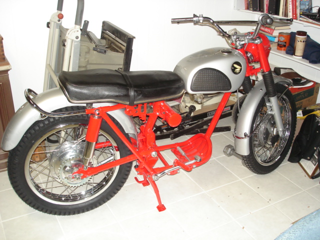

My frame needs a bit of care. The frame part that the front of the seat connects to is gone. I am thinking my best solution is to have someone weld on a replacement piece. Can someone on the site take a nice picture of there's and post it here for me to use as a guide. There is a small picture in my handbook, but not very large. Any other suggestions would be appreciated : )
Thanks! See below:
1966 Honda Scrambler Frame by BradSelenaDawson, on Flickr

Could someone with a '66 scrambler remove their seat and snap a photo of the seats front connector please and submit it.
I am not sure what the name of that part is called, but it is part of the frame.
Thanks guys.

Post by Livin'theDream » Tue Apr 10, 2012 10:48 pm
Never posted a pic before, here goes:
frt by mms44, on Flickr
rs by mms44, on Flickr
seat by mms44, on Flickr
hope this helps, Mitch.

Post by bdawson » Wed Apr 11, 2012 9:05 am
Thanks Mitch. Unfortunately this leads to a new question. Your seat bottom is different than mine. So... do i have the wrong seat? Or is your seat-to-frame connection different than mine because it is from a late '66 model and mine is an early '66.
Mitch you did a fine job of posting pics : )
I will post a picture of the seat bottom i have so everyone can see the connection I was thinking it would be.
Thanks again Mitch.
