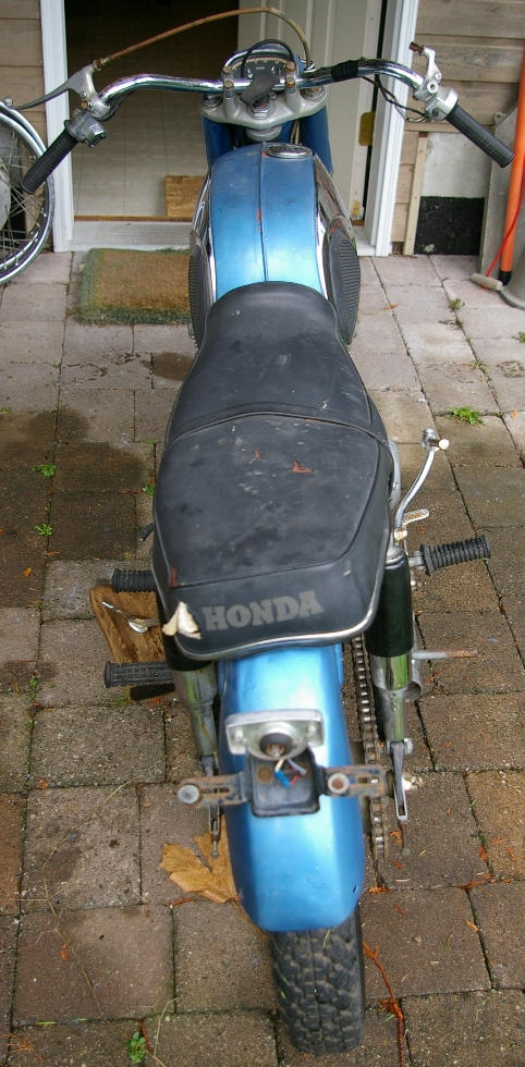

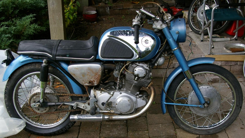

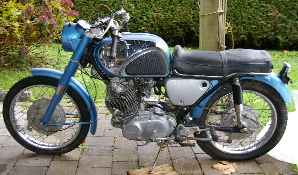

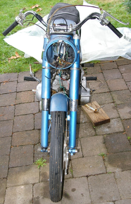

Here's the other sides from the first day home. It wasn't much to look at when I first saw it but I didn't ride the ferry and drive for 3 hours--an hour on forestry roads--to return empty handed. With it came 4 wheels and 3 boxes of used parts.
I knew the engine was siezed and it was obviously missing a few things--left exhaust, front brake lever, float bowl, half the ignition switch, the headlight and trim...but, it was a Super Hawk. The sidestand didn't appear to be correct because it would fall over without the aftermarket 2 x 6, and the seat looked oddly skewed, but I let it in the door anyways.

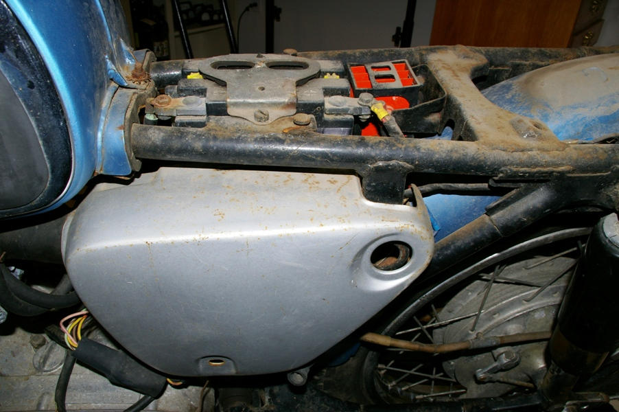

At least the side covers are in pretty good shape. The selenium rectifier will be replaced with a silicon bridge but there should be lots of room to mount it, along with a winker relay, to the existing bracket.

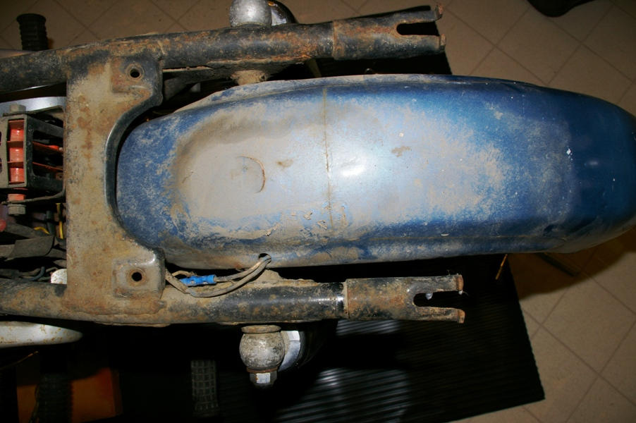

The bike will have to be stripped to the frame for cleaning and repainting, and it looks like the rear fender has already had some body work done to it (probably related to the twisted seat).

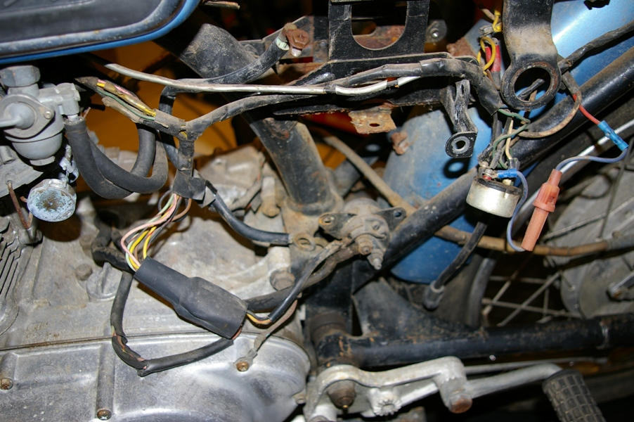

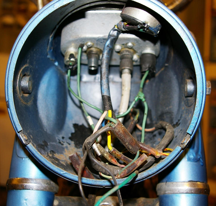

Uh-oh...the wiring is too much of a mess to be reliable. I may be able to use one of the harnesses from the spares box, and there's a complete ignition switch in there too, but no key.

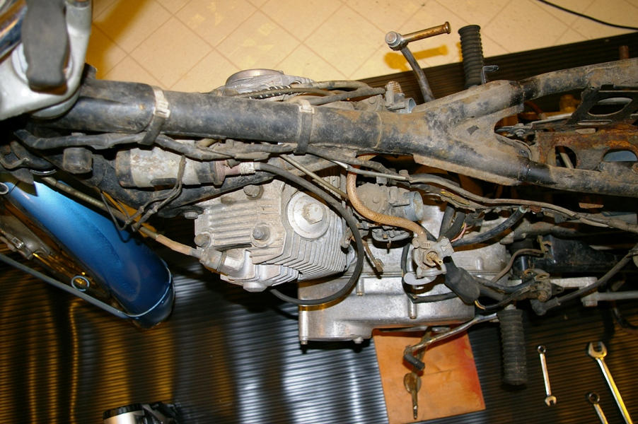

The head and top cover plate look pretty clean and all the fins are intact but the shift lever is beyond repair.

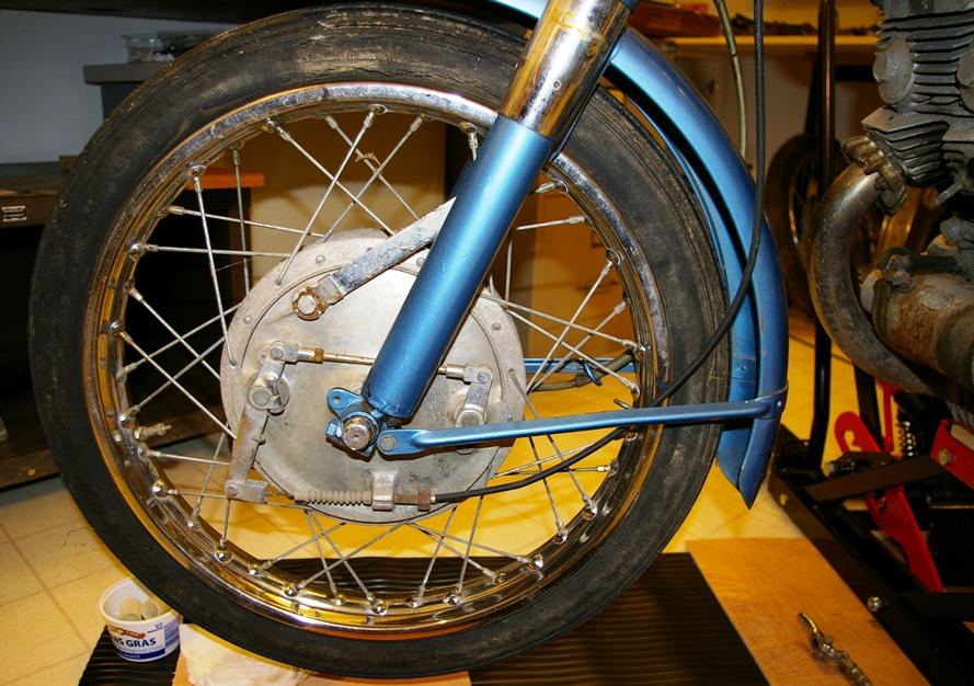

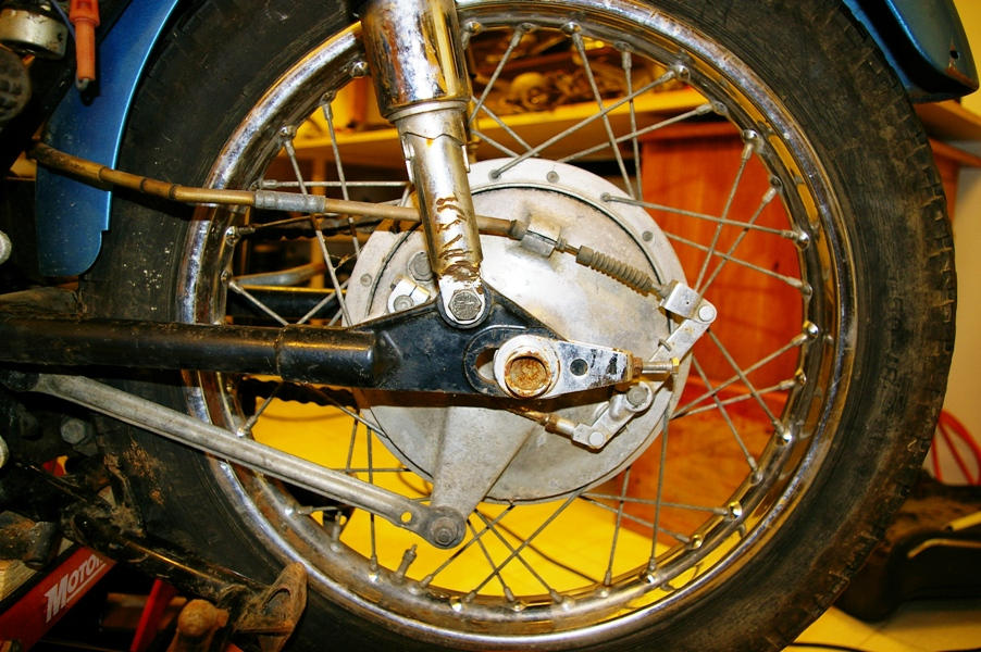

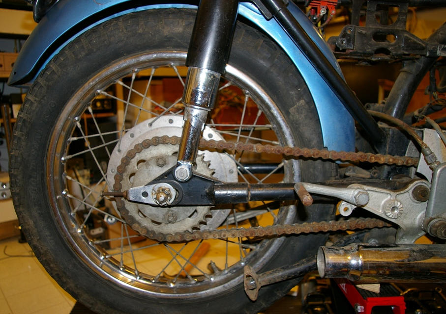

Add new tires to the growing parts list, and look for a front brake stopper arm that doesn't have the chrome plating bubbling up.

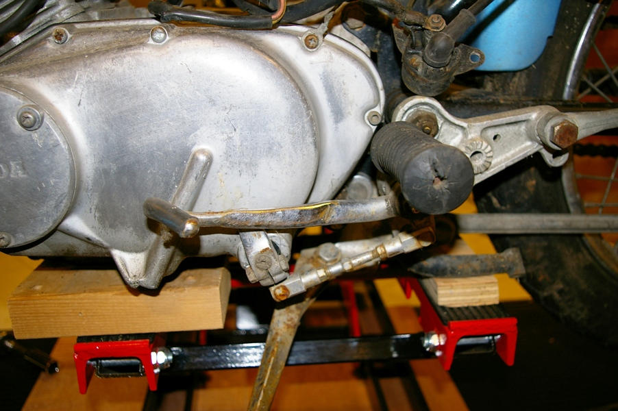

The rear shock shows a bit of road rash (possibly related to the deformed shift lever), and the crack and hole in the rear brake stopper arm are bad news. Fortunately FASTFRED has since supplied me with good used ones in addition to brake and clutch levers and a new carb bowl amongst other things.
Looks like a new chain and sprockets are also in order.
The front terminus of the wiring rat's nest--I think this is typical for an old machine. Reminds me of the wiring on the old gill-netter I once owned.

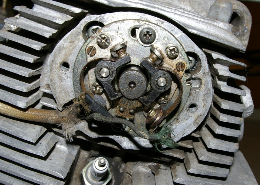

Add new points and condensers to the Retrobikes parts list. In a few days I might be able to rotate the points cam from its resting place of 35 years (just a few degrees before TDC on the left side).

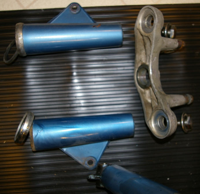

It's day 6 and time to tackle the front forks--the right one has been leaking all along, so they will both get new seals sometime soon. Fortunately there was a selection of steering damper rods in the spares box (I'm thankful to the donor for having held onto some of this stuff--he must have had an eye to restoring it at one time). I'll mix up a new batch of plating solution and make the metal parts all nice and bright again.

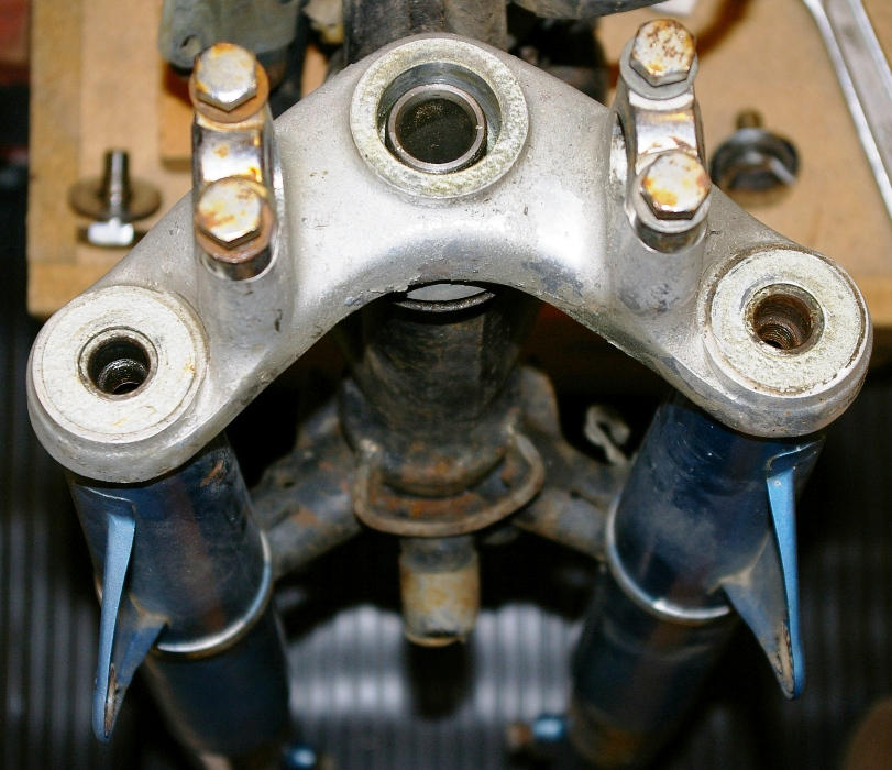

I hate clear-coat--it never lasts! A bit of fine steel wool should brighten up the fork bridge, and the chrome bits should brush up fairly nicely too.
I was surprised there was no packing between the bridge and the upper fork covers. A look at the Handle and Steering Stem fiches shows something there, but no dimensions for them in the parts list.

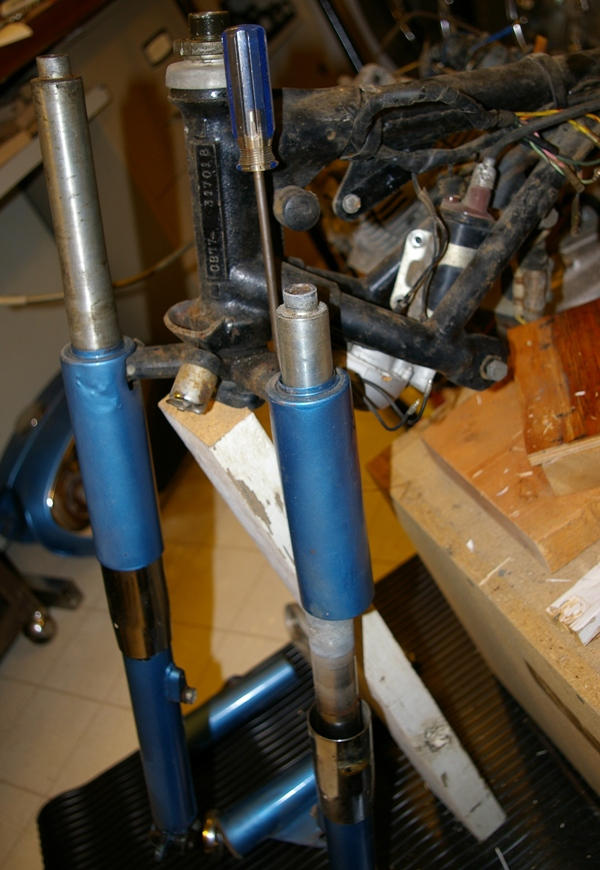

A bit of careful mallet work has freed the left fork rather easily.

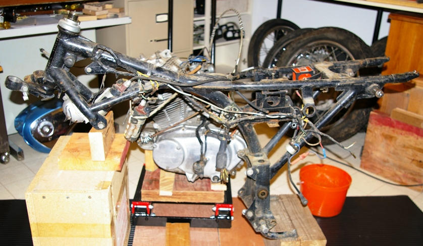

Finally the engine is down and clear.
