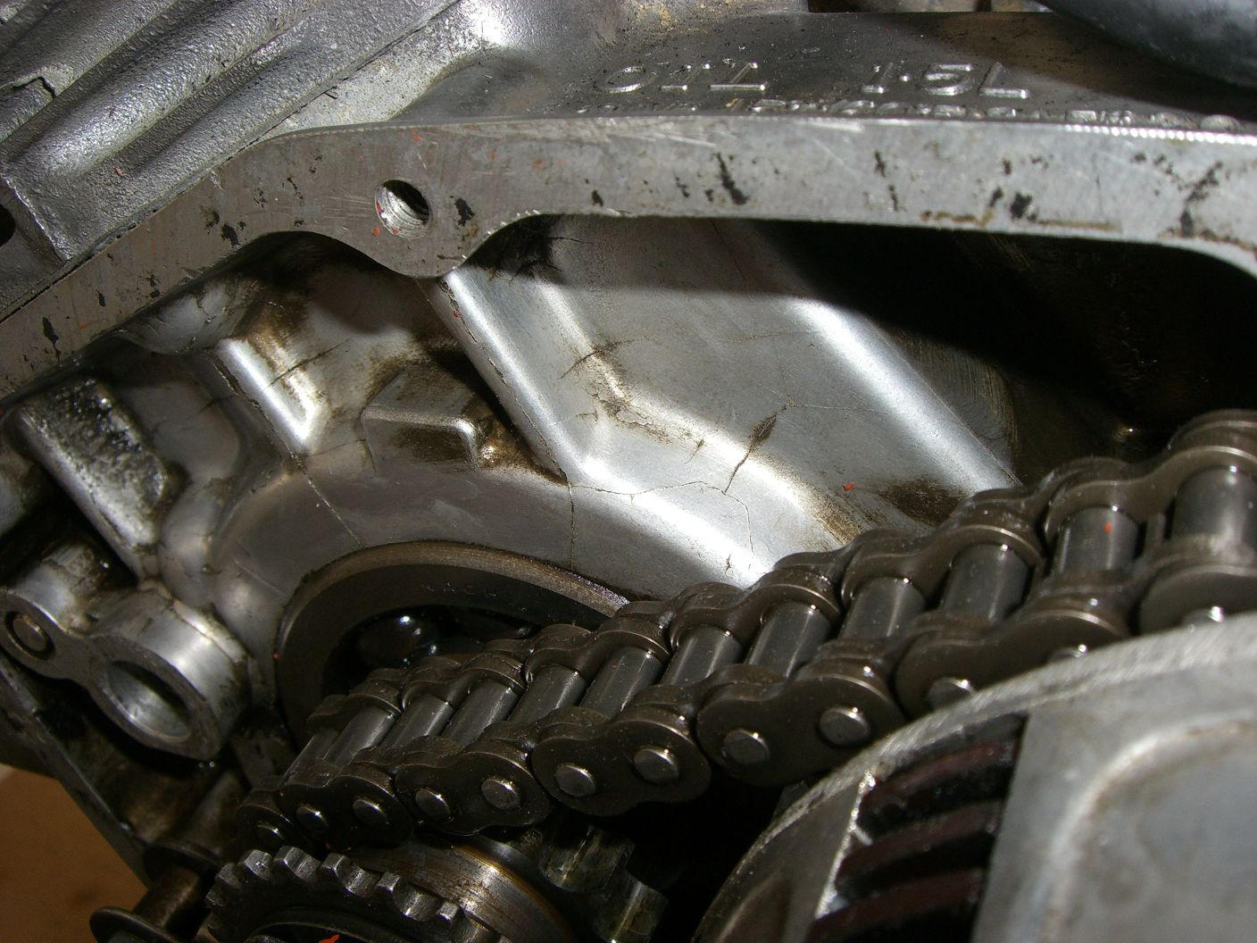

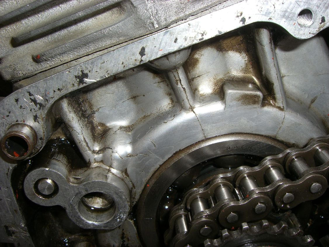

I found these in the upper crank case when I was working on the clutch. They don't seem to be all the way through. Is this a problem if they don't leak oil to the outside of the engine?

Casting imperfections. They're everywhere, if you look hard enough. You'll find them inside the clutch side cover too. Don't lose sleep over it!
