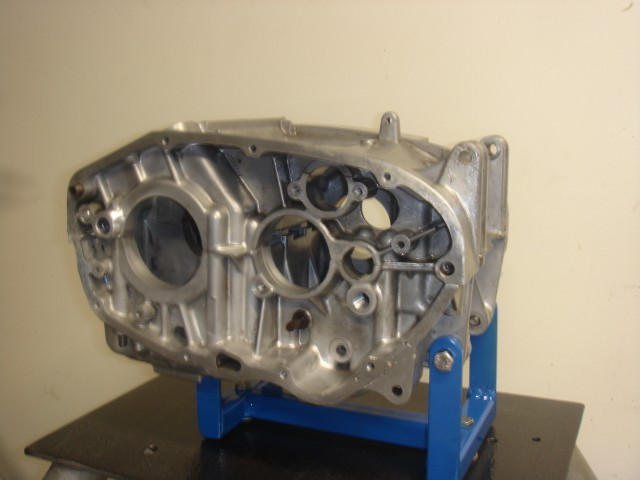

FYI if interested. Mounts to botton engine mount on oil pump and back 2 engine mt holes. Works great so far.
1" square tubing with (4) 1/4" x 1" uprights.
Beats the crap out of rolling it around on a bench.

Nice stand!!

Very nice JR - allot better than stacked 2x4's!

Mount that baby to a boat seat swivel on the work bench and that would be sweet. I've found the need to rotate the assembly alot and that would work awesome.

That plate is the top of one of my roll around bike build stands, I just spin the whole mess around. Once you get the trans and crank in and bolt the halves together, it works fine for everything else.
