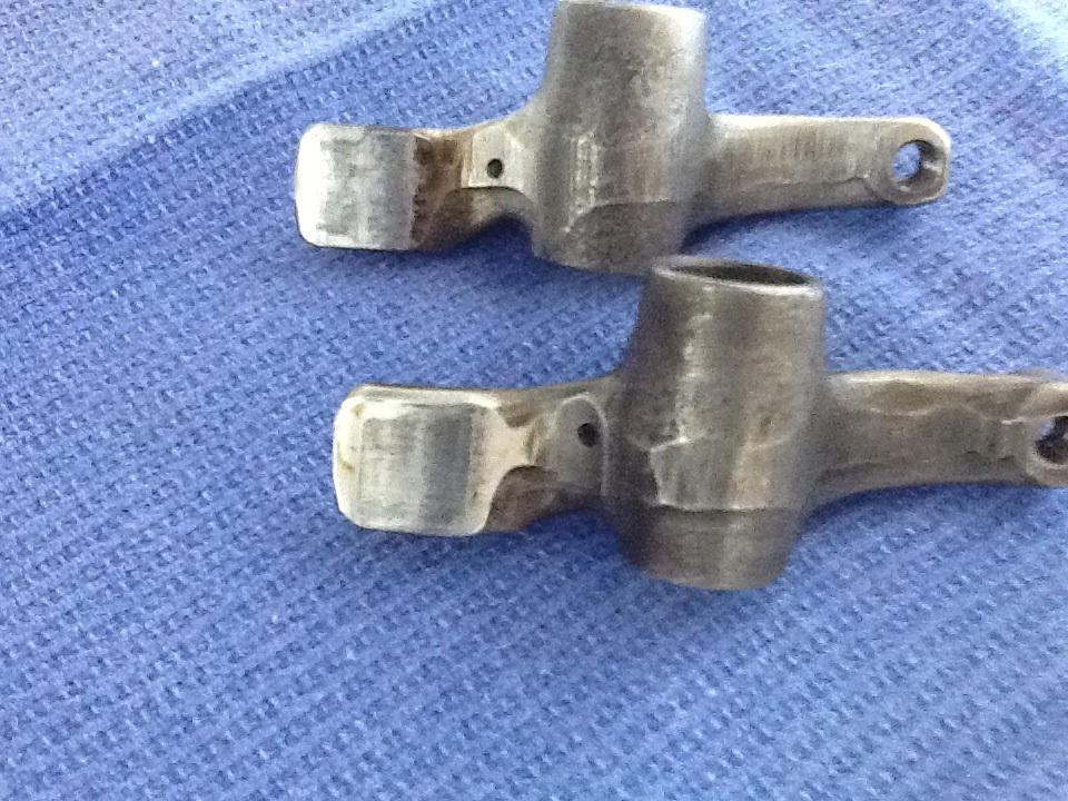

Sorry meant to say caliber, not micrometer. The pins measure completely in spec, but your right, much easier to get outside measurement. Fit with the pins has a very slight amount of play. First motorcycle engine tear down so I don't know what reasonable pad wear looks like. Will try and post a picture later today of the pads.

Photos of the rocker arm pads. Thoughts?
