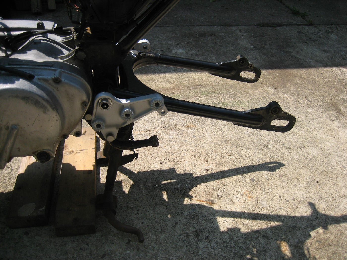

Post by mobilyte » Mon Jul 12, 2010 3:59 pm

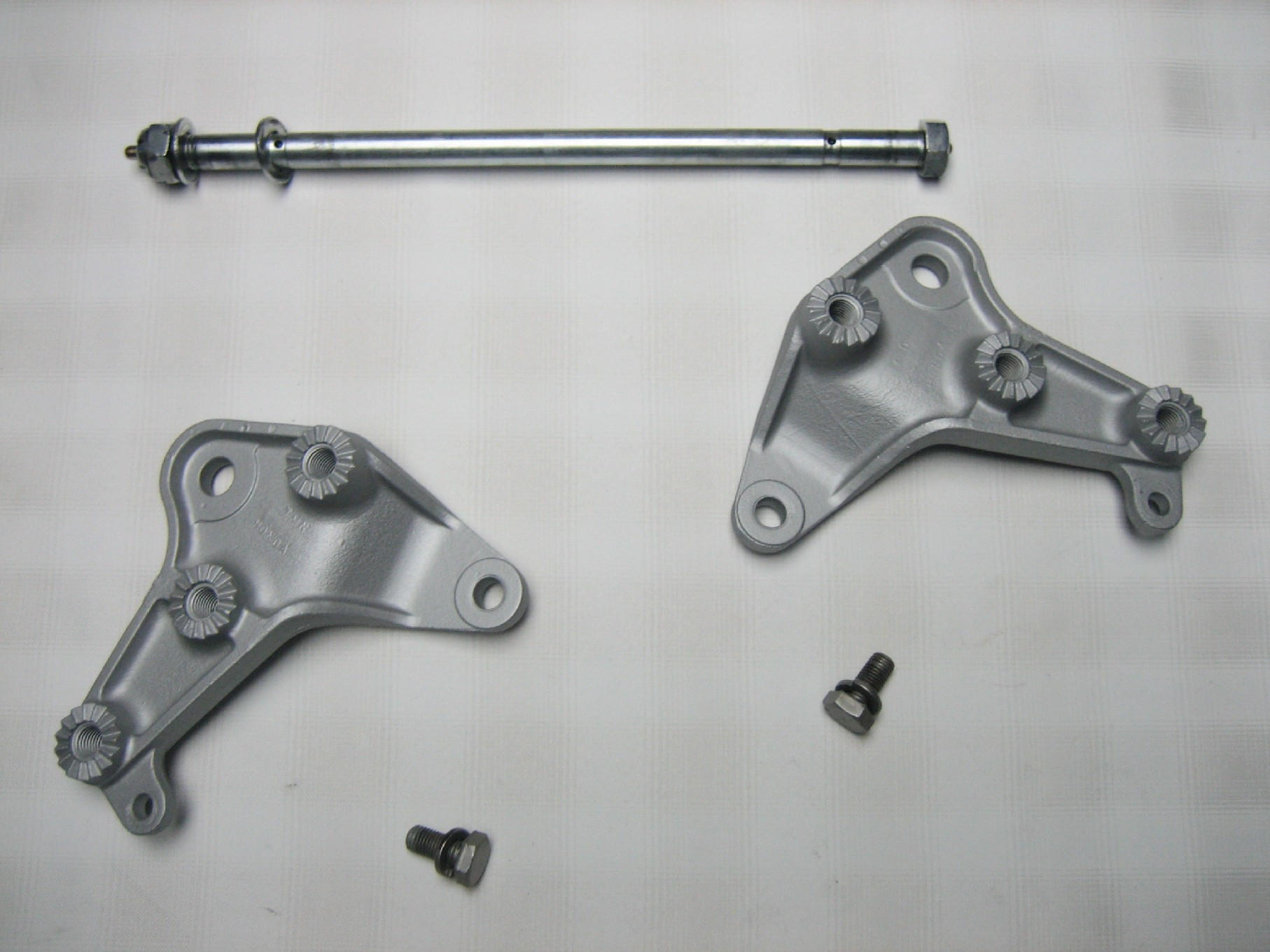

blasted the footpeg brackets, sealed/rattle can painted them.
cleaned/polished the swingarm bolt & nut, making sure the grease fittings arent clogged.

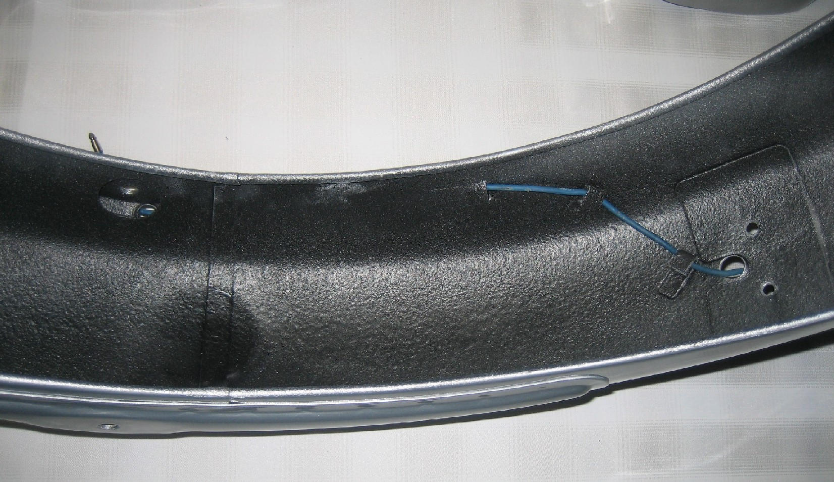

took the rear fender down to bare metal and repaired some large dents. primed the fender, masked the outside, applied a rubberized undercoat (aerosol can) on the inside, finished with paint.

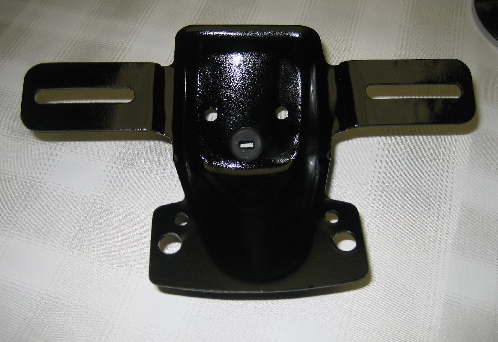

blasted the taillight bracket, straightened the license plate mounting areas, primed/painted. had to replace the old rubber wire grommet with a new one from ohio cycle.

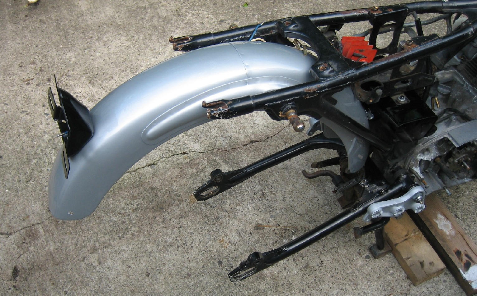

Post by mobilyte » Mon Jul 12, 2010 7:15 pm
one fender is better than none!
