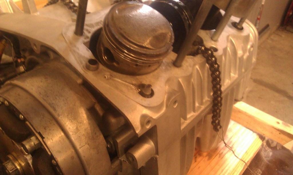

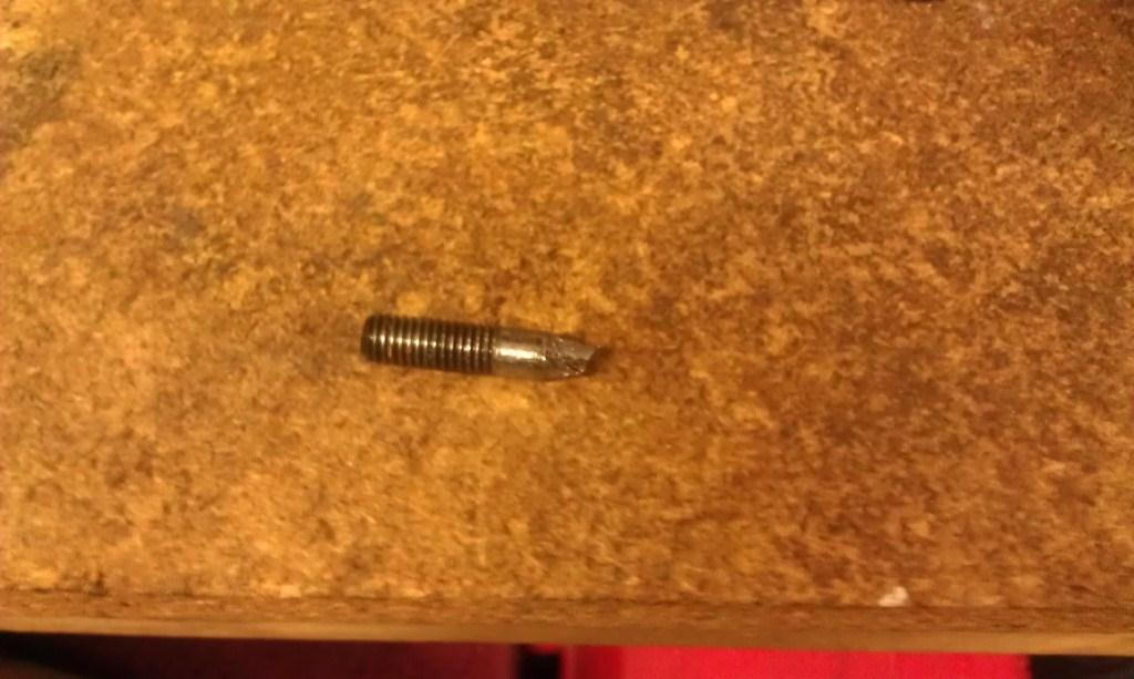

I would drop a nut over what's left of the stud and weld the hole full, then while it's still warm back it out with a wrench. Might help to warm up that corner of the case as much as you can first.
