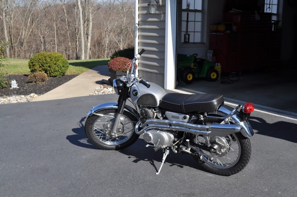

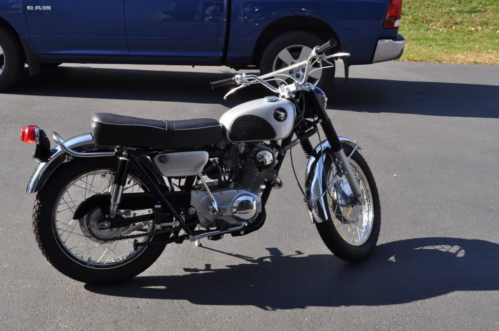

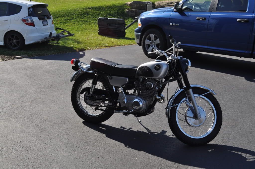

It’s been a while since I last updated this thread. Last fall I got the bike mostly complete and was able to put 100 or so miles on it. Here is a few pictures of what it looks like. I am still working on a seat but in the meantime what I have looks pretty good.
I had a problem with the clutch so back in the basement it went. I tore the clutch out an inspected everything and couldn’t find a thing wrong. I spent a few hours reading everything on the site about clutches and decided all I need to do was scuffed up the steel plates. Also while at it I found what I think were the original carbs for the bike so I cleaned them in an ultrasonic cleaner (that a friend loaned me) and installed them. So that’s where I am at now. The bike is on the lift waiting for warm weather.
