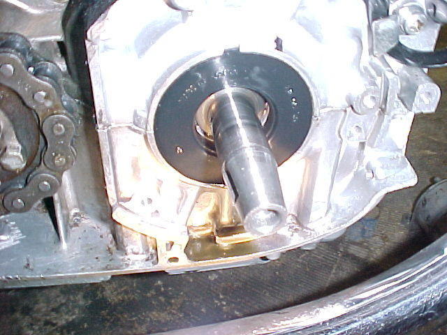

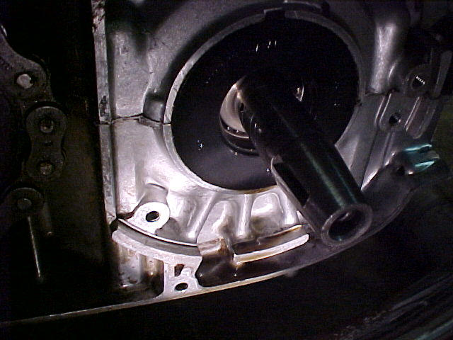

I have a 64 305 CB77. I have replaced the right side crank bearing seal with a new one, the one I replaced looked new as well, but I still have an oil leak here. The back of the starting sprocket bushing area looks nice and smooth. Here's a couple pics of oil leak. Any suggestions? The seal is installed flush with outer case.
Thanks, Davomoto

How is the surface of the starter sprocket.
Ruff? Grooved? ..................lm

Post by davomoto » Tue May 15, 2007 6:15 pm
Thanks for the reply! Nice and smooth. I do notice that it is rather shallow, as in not a lot of surface are in seal.

Post by LOUD MOUSE » Tue May 15, 2007 6:17 pm
Be sure it goes all the way up the tapered shaft with the rotor. .............lm

Post by davomoto » Tue May 15, 2007 6:25 pm
yes it goes all the way in, and the fixing plate bolts on flush. i just used my last new seal on a complete rebuild that's sitting on my bench. i will order more seals soon.

So, I installed another new seal, but this time I coated the outside of the seal with three bond 1104, the same sealer I use for crank cases, and installed it flush with crank case. Problem solved. One note, the seal I installed was a 6.5, instead of the standard 7.5 width. it was what I had, and it worked. Thanks for the input.
