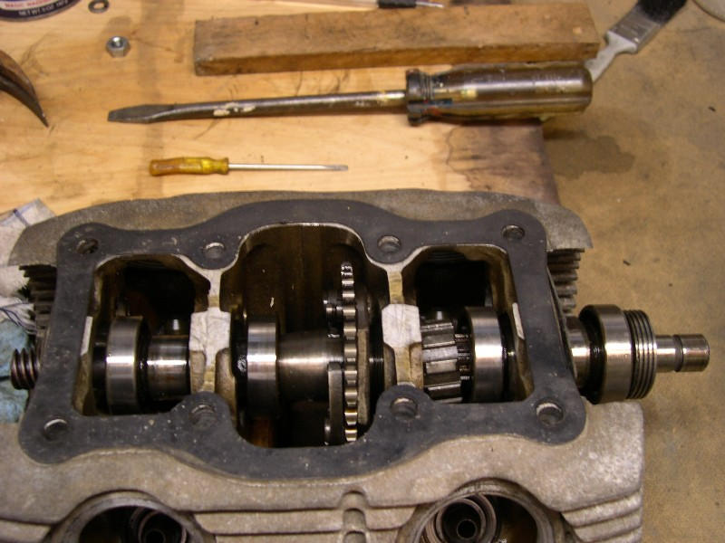

305explr
Posts: 76
Joined: Sun Apr 01, 2007 11:14 am
Location: Pennsylvania
A Pic of my situation. Advice appreciated!
Post by 305explr » Mon Jan 14, 2008 8:56 pm
A pic...as requested.
As you can see, the rt. half of the cam is separated from the right side of the cam sprocket. Note also how the ENTIRE cam assembly is headed right, and is hanging free. My questions is... now what?
1.) How to get the rt. side assembly out of the engine.
2.) How to separate and remove the left side from the cam sprocket.
The ball bearing "cages" are intact and a-ok. In my above post, I called them retainers b/c that's the vocab in bicycle mechanics, which is what I'm familiar with. Bearing retainers as opposed to sealed bearings, as opposed to loose balls. I'll gladly use bearings if that term keeps things clear for everyone.
Hope this helps!
rt.half apart, but stuck. Also, entire assembly has shifted rt. How to proceed in removing cam w/out damaging anything.
