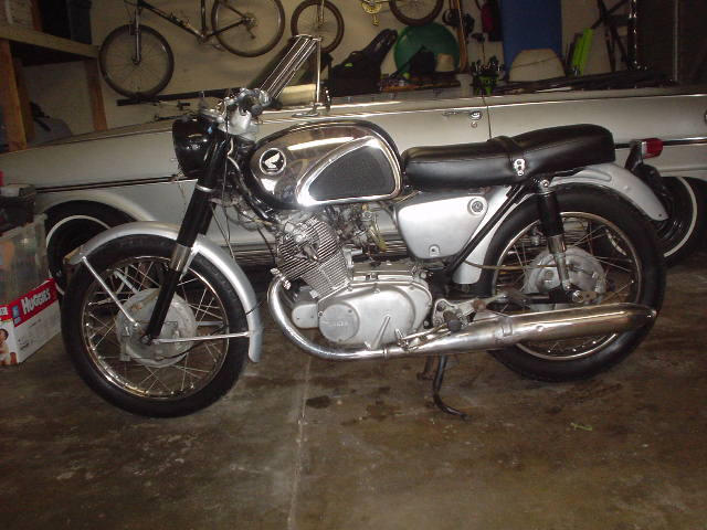

While attempting to set the points on my cb77 for the first time we discovered that the entire assembly was in upside down. After turning it 180 degrees and reassembling it the bike back fires shooting flames out of pipes. Did I set points incorrectly? Did the wiring get crossed somewhere in time? What the h*#l?
