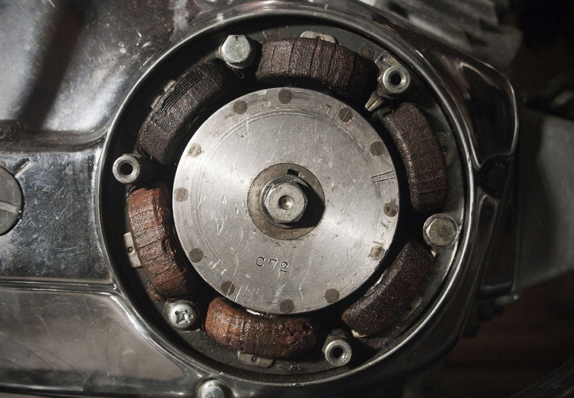

I was reading an old post that a Rotor marked CB72 is better than a CB72(L).I have one that came off of a CA72 marked with C72, all the others on my CA77's have the C72(L).Can I assume the C72 is the better one like on the CB72?thanks

Yes. The magnets are stronger. .............lm

I've always wondered what was up with my rotor/stator. I noticed that it was stamped C72. PO seemed to have no aversion to adding a number of parts from CL's and Dreams.
Mine has the LT & FT carved in with some sort of dremel. Do the dreams not come with that stamped on? How does one go about determining the proper LT & FT marks?
