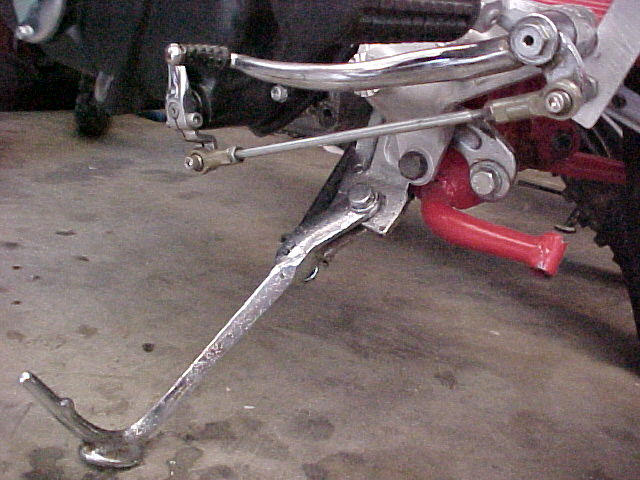

Does anybody make a longer adjusting shifting rod so you can move the foot pegs back to the rear location?
Can any other side kick stand be mounted on the cb77!!!
Post by davomoto » Fri Aug 08, 2008 2:41 pm
Yes, DID chrome steel rims, fromt tire 2.75-18, rear 3.00-18. You can make your own longer shift rod from 1/4 inch rod, and two 1/4 inch rod ends Only the very spendy Honda kickstands as far as I know. here's a pic of home made shift rod.

davomoto wrote:Yes, DID chrome steel rims, fromt tire 2.75-18, rear 3.00-18. You can make your own longer shift rod from 1/4 inch rod, and two 1/4 inch rod ends Only the very spendy Honda kickstands as far as I know. here's a pic of home made shift rod.
Thanks for the reply about the longer shift rod. I spent about 2 hours last night reading old post and saw your longer rod after I posted. I'm a retired machinist and figured I could make one, just thought I see if one was even avalible <sp?.
