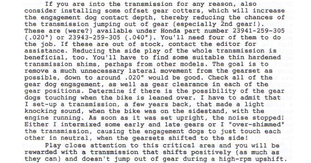

Post by e3steve » Mon Sep 29, 2008 5:04 am
Hi Ken, Steve (your eBay colleague!) here. Do you have a copy of Bill Silver's Restoration Guide? Here's an extract regarding trannie-shimming (not an arrestable offence).
