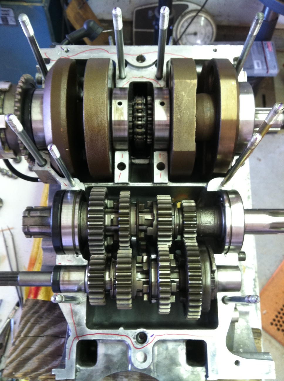

All done. Fast Fred just left. We put it all back together, put the cases back temporarily and checked the shift clearances. Dogs are happy :)

Here we go ... all X'd and ready to be buttoned up.

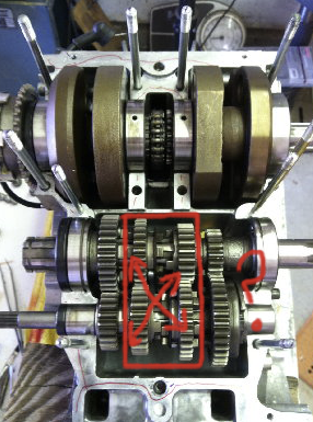

hey all i'm just a little confused as to what i should do here. i drew a diagram on the picture provided here, as a question of which ways the gears should go when "crossing" them. the picture here shows them already crossed but does what i drew make sense ?
thanx
