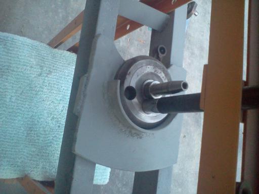

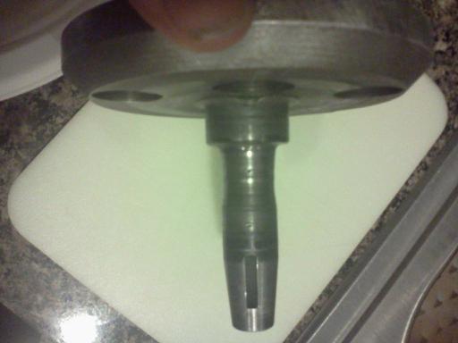

The first pic below is the end of my crank that is bad. PO apparently rode it a ways while the starter clutch had insufficient oil. Must have made a God-awful noise. You can barely see the oil hole in the reflection line. It is about closed up. On close inspection I found that the shaft is cracked out from that oil hole. CL72 shop manual says the end counterweight pieces are made of carbon steel.
The second pic is the jig I made in action in a 12 ton press. Jig is resting on a new cross-bar that I made up. You need a 1/8" spacer for the end that goes farthest into the jig because the inside surface of the counterwieght is not flat. Got some good pressure on it and then hit it with a 3 pound drilling hammer. It moved a little and then the press did the rest of the work. Have someone catch the rest of the crank or the con rod could come off and scatter those little roller bearings to Kingdom come. I caught both this and the donor crank, and avoided that problem, but did briefly lose one of the rollers from the donor crank. They are pretty small.

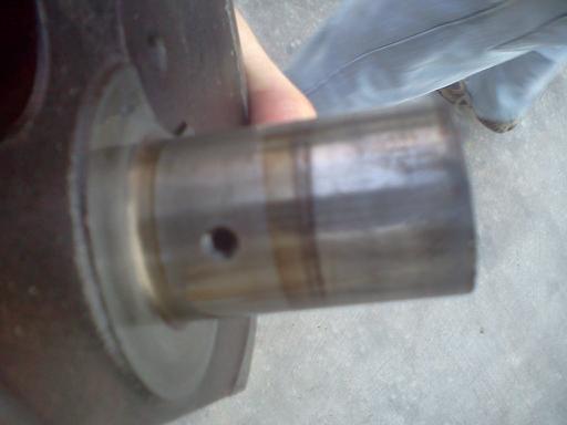

First pic is the con rod shaft. I got just a little bit of crud out of the oil holes. When you use carb cleaner I think it flushes a little of the crud out and and softens the next layer each time you shoot it into the crank, so if you start that process, probably a good idea to do it a number of times over several days. The last couple of times I sprayed the carb cleaner, what came out looked pretty clear. I am not sure how you can tell when you are “done”.

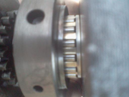

Third picture is the inner bearing next to the cam chain sprocket. Next to it is the annular groove that Teazer talked about. You can actually get at it fairly well and clean it out. I had run a lot of carb cleaner through this bearing so the crud was fairly soft and easy to remove. You can clean out this groove even if you don’t take the crank apart, but remember you are disturbing crud that your bearings won’t like so be thorough in shooting carb cleaner from every angle to flush everything until it is really clean. The starter sprocket oil hole does NOT go back directly into the con rod bearing, so squirting from there will not make it back into this bearing or into the con rod bearing.

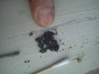

Last picture is what came out of the crank after gouging out the impacted crud and spraying carb cleaner through the con rod shaft, annular groove and inner bearing. I got a little dirt and 2 metal pieces and I am not at all sure where these came from, but likely from a piston that came apart early in this motor's life and repaired by the PO. If that is the source they went through the oil pump and inner roller bearing without causing any significant damage and I think were caught in the annular ring so they didn’t make it into the con rod bearing. Simple, but effective Japanese engineering. When you start loosening this crud up, it can send metal like this through your motor. It may be that my prior question about whether it is just better to leave this stuff compacted and in place may be the better way to go. I haven’t decided what I think yet. If you loosen it up it could go through the motor. If you leave it in place there may not be any room left in the annular ring to catch the next piece of metal. In either case, it seems like the annular groove was designed to catch and hold crud and metal and, if doing its job, it will fill up again at some point.

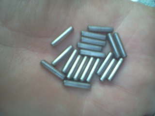

I knew it was a '60 motor before I started, but didn't connect the dots. It uses 3x14.5 rollers. Everything after that first 1,050 bikes in ’61 uses 2.5x13.5 rollers. Rods are the same for either crank. So…..the con rod shaft in the early crank is smaller (0.984”) to allow for the bigger rollers and when I tried to put the counter weight from the later crank shaft on my early crank the hole in the counterweight was too big (1.024”). DOH! Or, as Agent Maxwell Smart would say, “Missed it by that much” In this case I missed it by .040.
