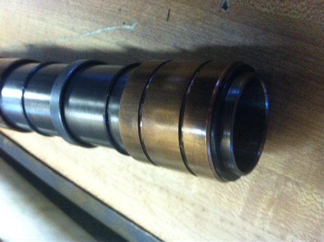

I am putting the front forks back together and I can't remember if this is the right order of things. Do I have the tube components in the right order?
Also, there is a beveled side of the silver ring. Does it face up or down?
66 cb77
Hope the pic works!!
Ian

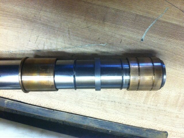

Here is another view

Post by G-Man » Sat Jun 21, 2014 1:15 pm
The steel ring fits above the lower bush with the flat circlip above it.

Post by versuspop » Sat Jun 21, 2014 2:30 pm
Thanks- and does the orientation of the steel ring's bevel matter?

Post by G-Man » Sat Jun 21, 2014 3:10 pm
The bevel does matter but I cannot recollect which way it goes.
Down, I think as the flat upper face then rests agains the flat circlip.....
Post by LOUD MOUSE » Sun Jun 22, 2014 6:58 am
You are correct. ...........lm
G-Man wrote:The bevel does matter but I cannot recollect which way it goes.
