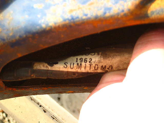

Post by G-Man » Wed Aug 18, 2010 10:15 am
Bonjour
here is a label from my 1962 C72, you can just make out the 61 on the label. Also a rather clearer label from my spare parts C72.
Yours may be completely faded.
C72 Wiring harness
C72 Wiring harness
Tag from Spare C72
Tag from Spare C72
