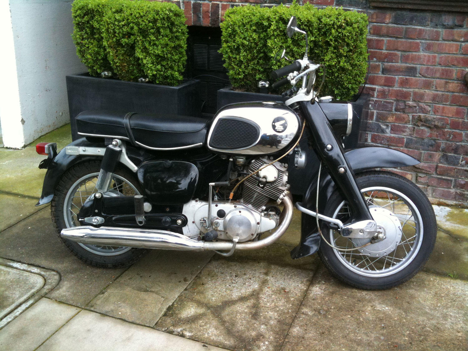

that's
Post by Kevmcp » Sun May 02, 2010 9:36 pm
How mine is mounted, and it is original

Post by joeweir1 » Mon May 03, 2010 3:22 pm
I route mine along the frame under the tank.Also, are your tank badges on the wrong way?
