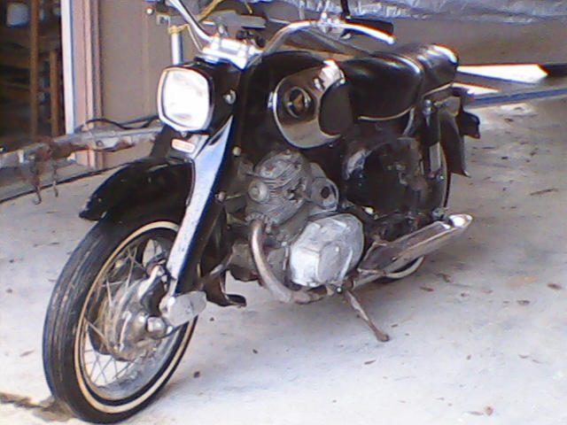

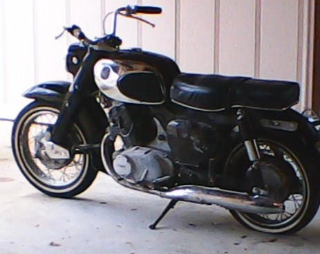

Two bike pics below are BEFORE any work began. Me painting is recent pic.....
Got this bike in Feb 2012. Pretty much unmolested, 5 K miles, engine locked with extensive rust on R. side where it sat under edge of shed for 32 years. Have torn down to frame, engine on bench, parts labeled. First step was sandblasting frame and all sheet metal.

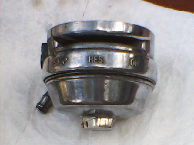

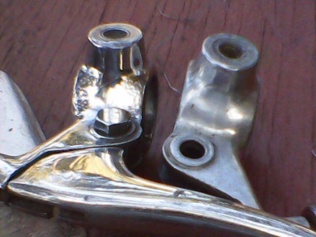

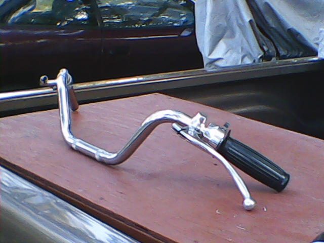

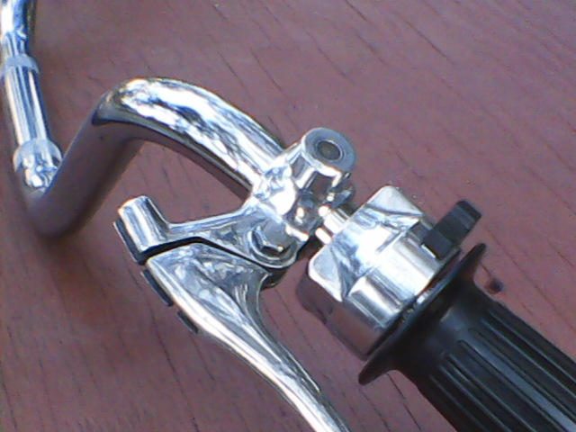

Restored the handlebars today. Originally I was going to trash them but on second inspection decided to save them. I want to re use as much original parts as possible.
1) Cleaned everything and rust spots with steel wool.
2) Reworked wiring/switches/contactors
3) Buffed out perches, switches, levers with jewelers rouge. Wowzer!
4) Straightened the bars. Right handle grip was 1.5 inches higher than left. Have them within 1/32" now.
5) Cleaned and serviced original throttle cable and throttle slide... both excellent shape.
First pic below shows perches buffed and not, side by side. Next will clear coat everything and spot touch paint the small rust spots on underside. I am happy with decision to rework the bars. Will keep the aftermarket Grand Turismo grips...my 750 four had them and I like them.
Last edited by hondadreamca77 on Wed Oct 17, 2012 10:15 am, edited 1 time in total.

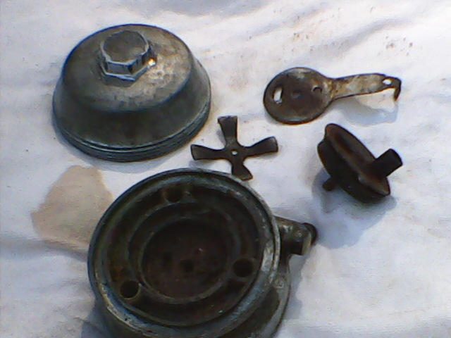

Post by hondadreamca77 » Sat Oct 13, 2012 5:08 pm
Did the messed up petcock repair today...in and out. It was totally clogged, crudded, etc. I did use a rebuild kit. If doing over again I would just order a ebay petcock replacement. This was the biggest hassle on doing the bike.

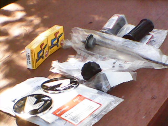

Post by hondadreamca77 » Fri Oct 19, 2012 6:11 pm
Well,...I'm down to ordering all the detail goodies....found a great deal on Firestone 4 ply vintage tires and also got NOS peg rubbers, badges, NGK plug boots, latch knobs, etc. Pics below.
Last edited by hondadreamca77 on Sat Oct 20, 2012 10:26 am, edited 1 time in total.

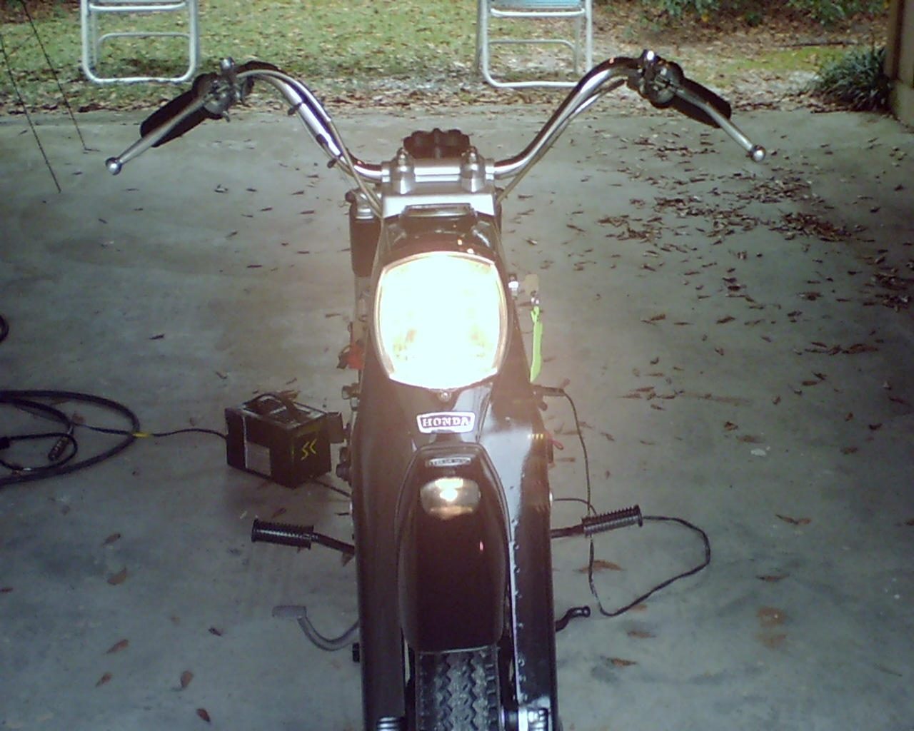

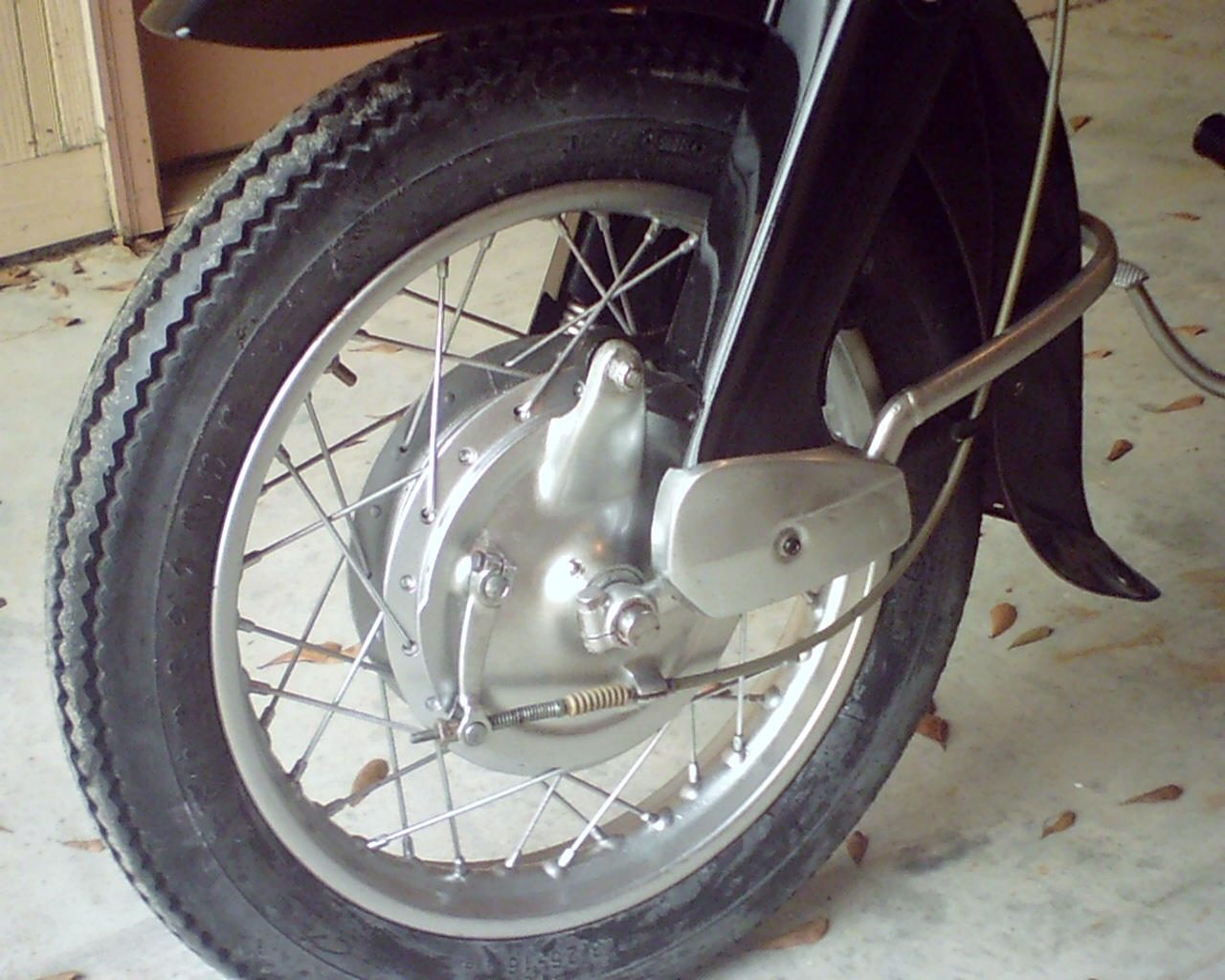

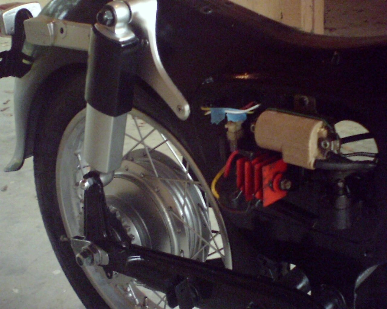

Post by hondadreamca77 » Fri Nov 16, 2012 4:01 pm
Lights, camera, action....got the wiring and wheels done. Everything works first try! This is starting to look like something and I'm pleased. Pics posted....
