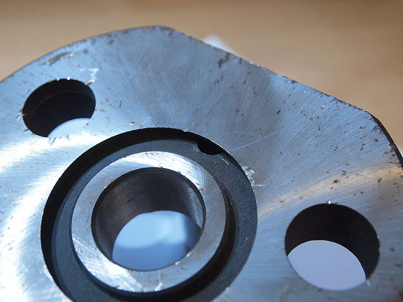

Post by G-Man » Tue Jun 07, 2011 1:20 pm
Bill
The 'lead' you were looking at is, I believe, an aluminum plug which blocks off the oilway drilled through the crank pin. It breaks through into an annular groove in the other side of the web, providing an oilway to the big end.
As you can see, the pin is parallel so the 'plug' does not interfere with the dismantling process.
Incidentally, you can use those holes to roughly align the crank at reassembly time.
Inside face of crank web
outer face showing big end oil hole and plug.
