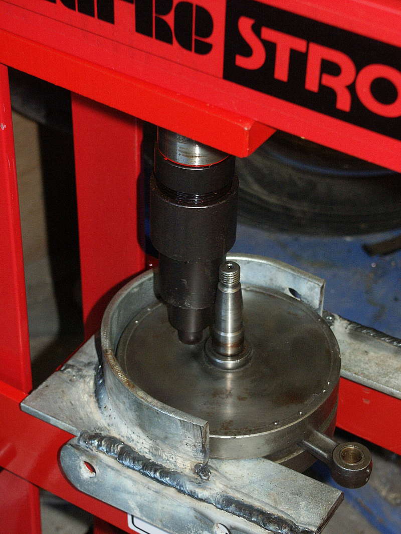

I dismantled a BSA Bantam crank using my 10 ton press at home and the press was creaking a little when the crankpin finally started to move. I had to build a special jig so that I could hold the crank securely in the press.
How are you supporting the crank in the press? It may be that 12 tons is not enough for these cranks or that (perhaps) you are pushing against the wrong surface.

I cut 2 10" sections of 3/8" thick angle iron. 5" sides so pretty hurky stuff. We didn't put all 12 tons to work, but the angle iron seemed to handle what we gave it and should work fine. Slid those under the outside counterweight and pushed against the con rod shaft. Requires a spacer under one side of the counterweight.
